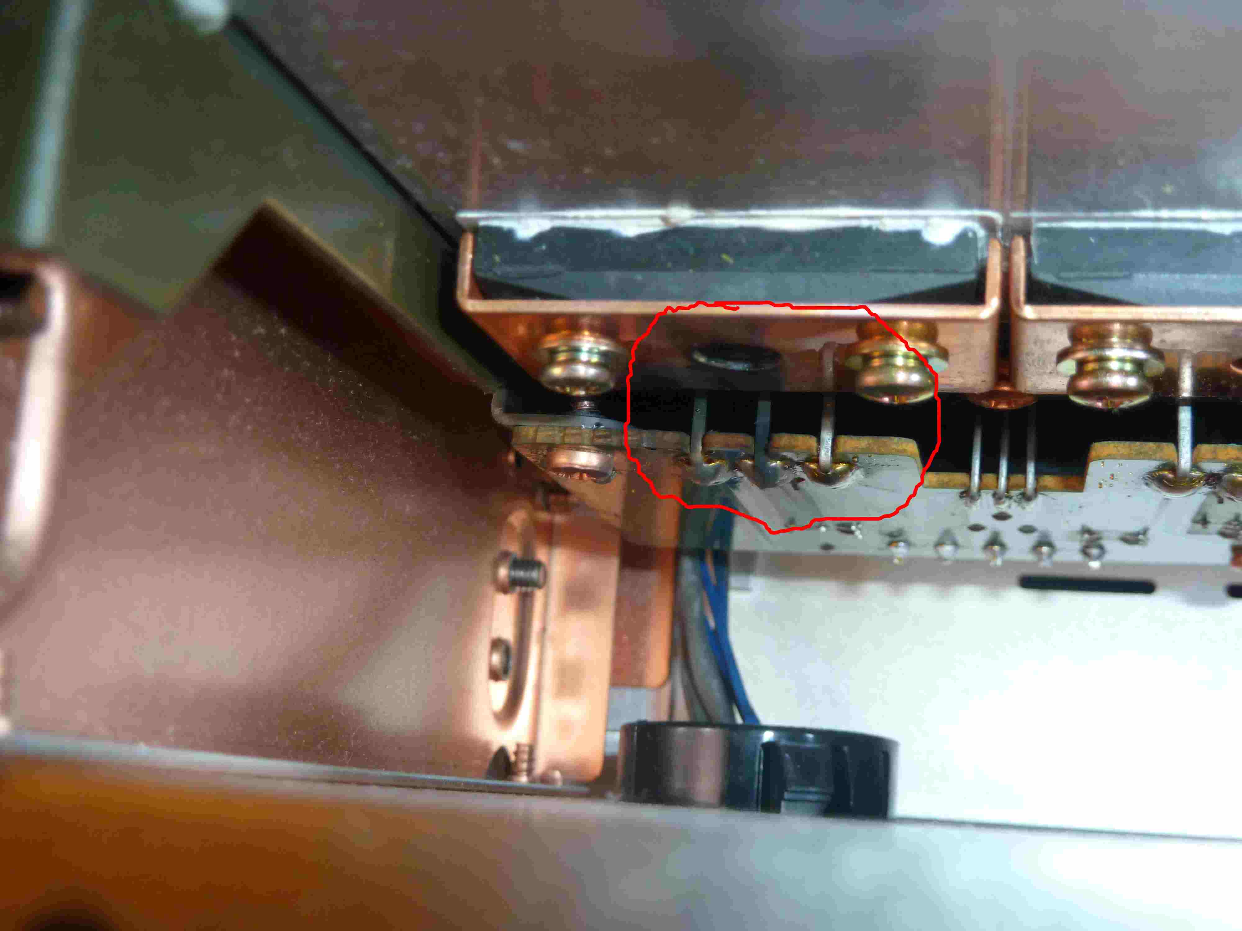

    die Endstufe meines Sr14 hat sich verabschiedet siehe Bild.
    Kann man dies selber reparieren, wenn ja, wo muss ich welche Bauteile bestellen. Wenn nein, was kostet so eine Reparatur?

              The SR14 has a known problem: Bad solder joints in the power supply section, once these solder joints break (and they will), the amplifier will self destruct, which is what probably happened to yours.
              Be very careful to not just replace the broken transistors , but completely check all solder joints!
